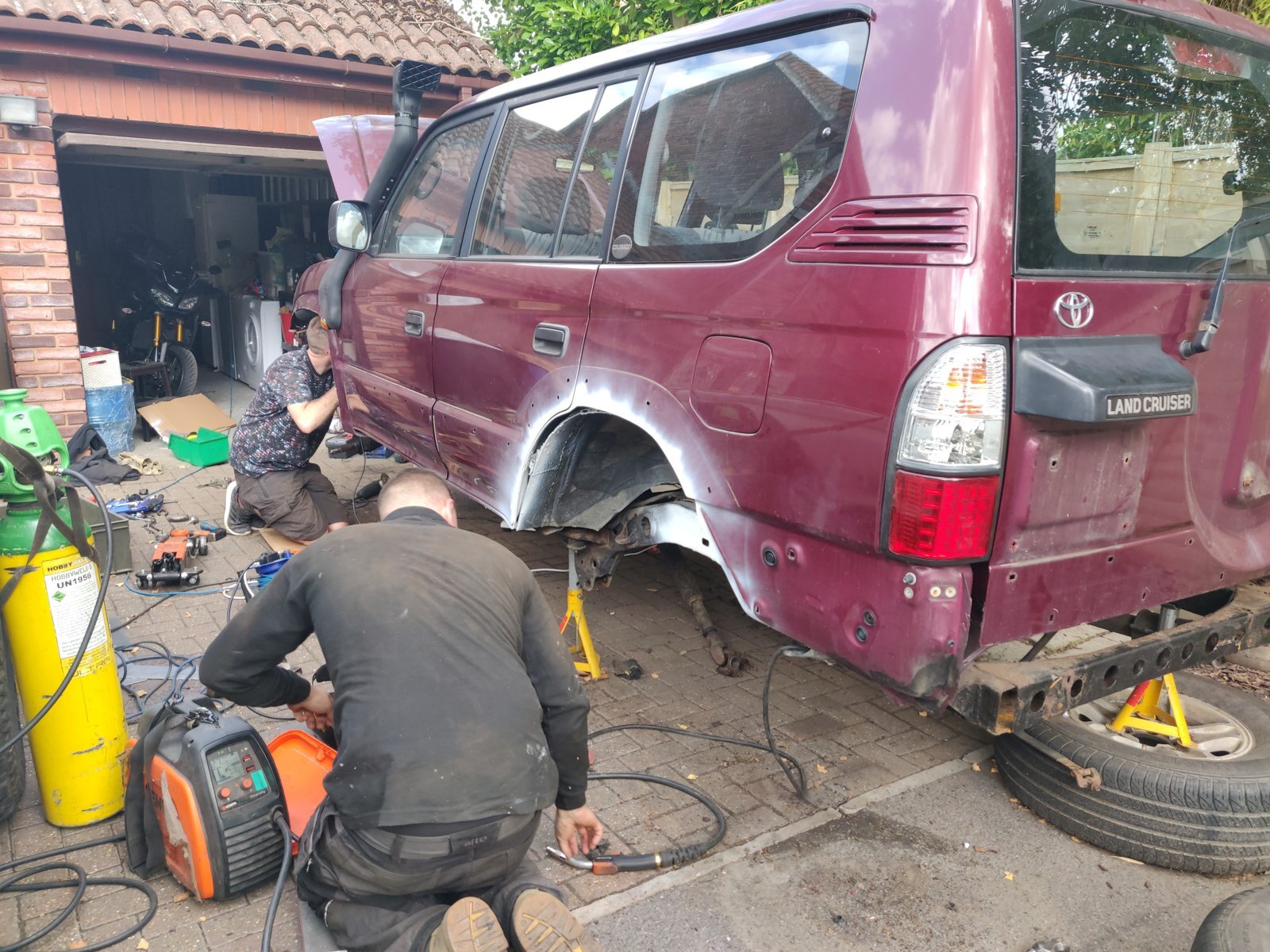

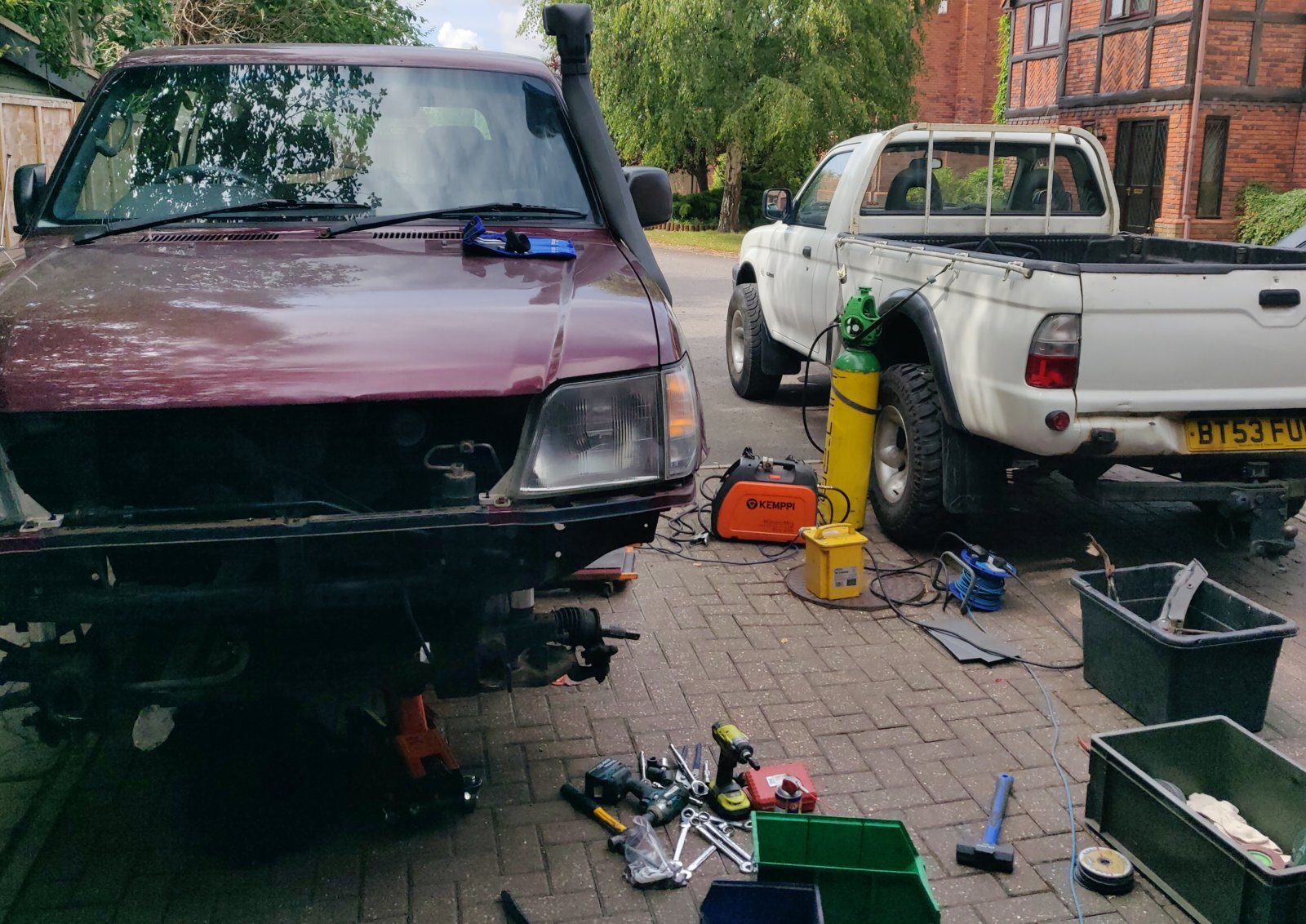

    Few progress pics

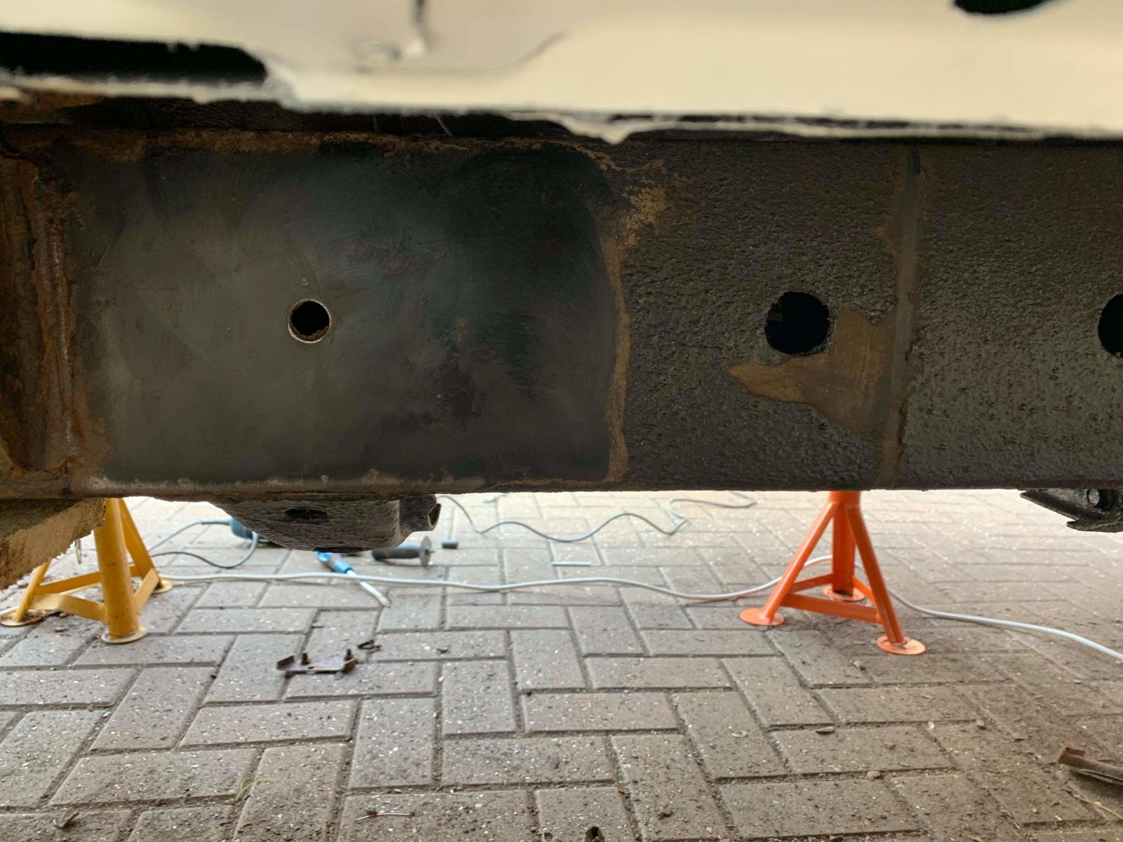

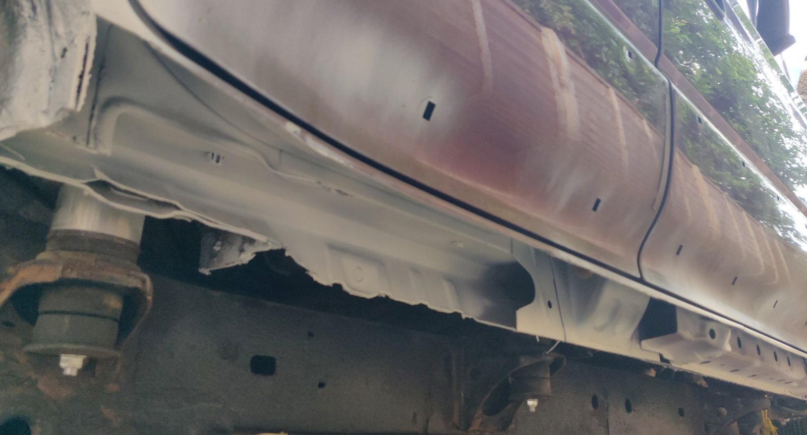

    All chassis welding done, all remaining rot cut out, arches and sills prepped for mods. Steering rack and bottom arms out. Tomorrow its underside cleaning and painting.

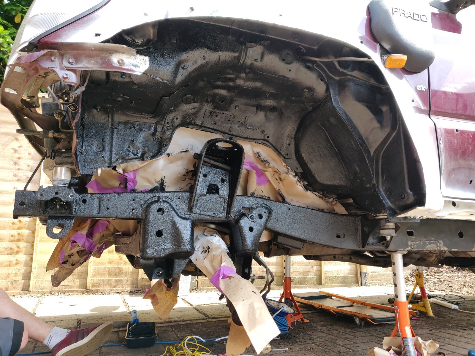

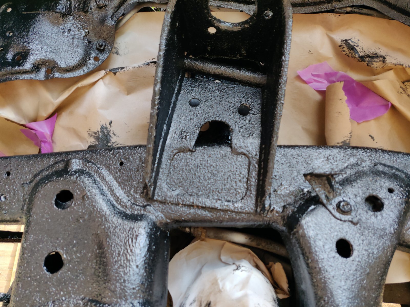

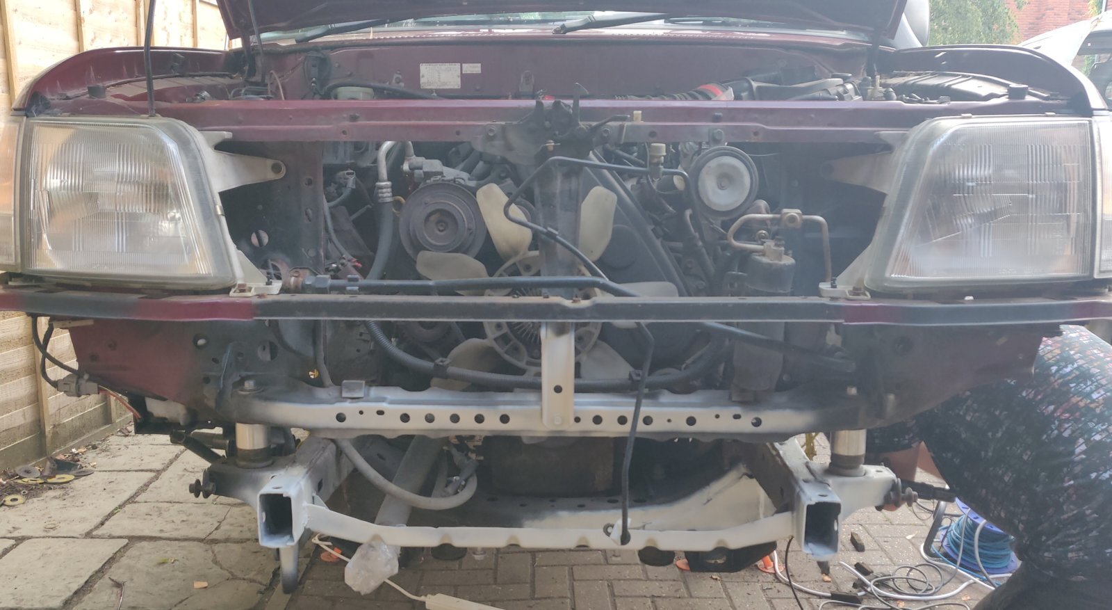

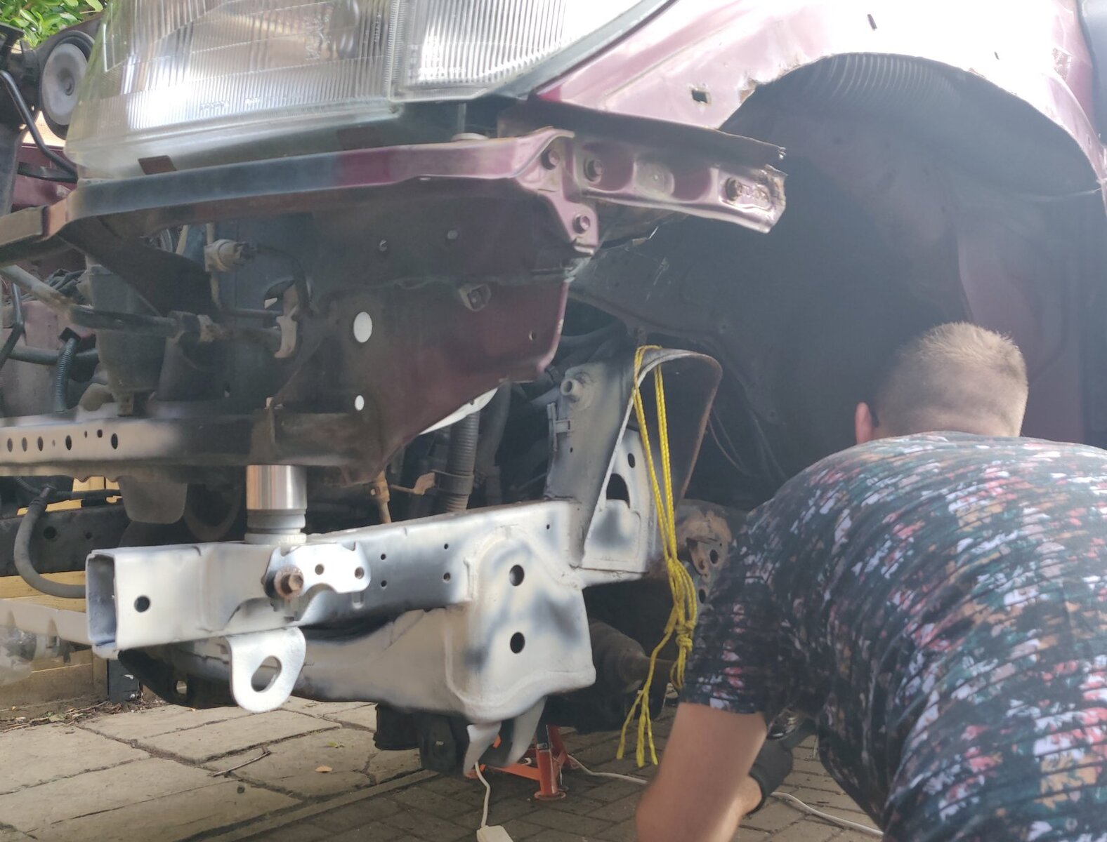

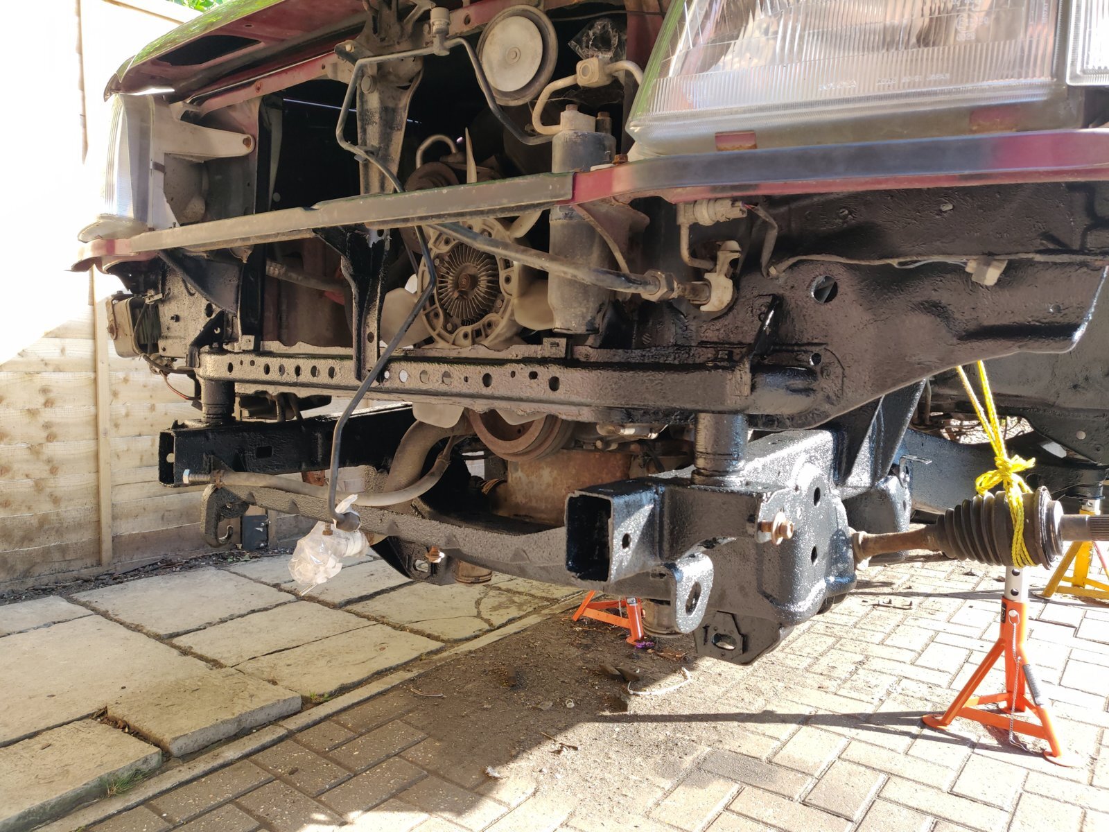

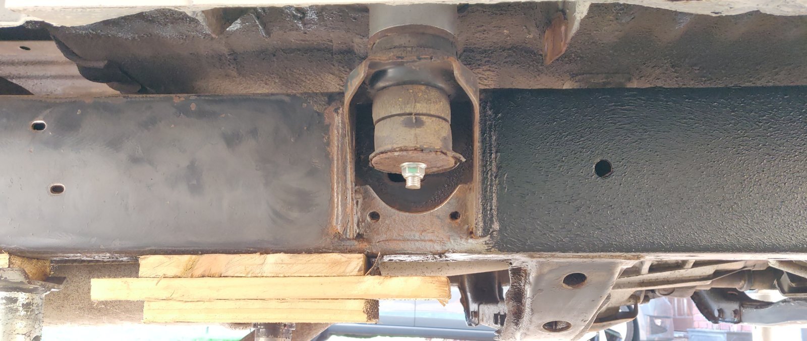

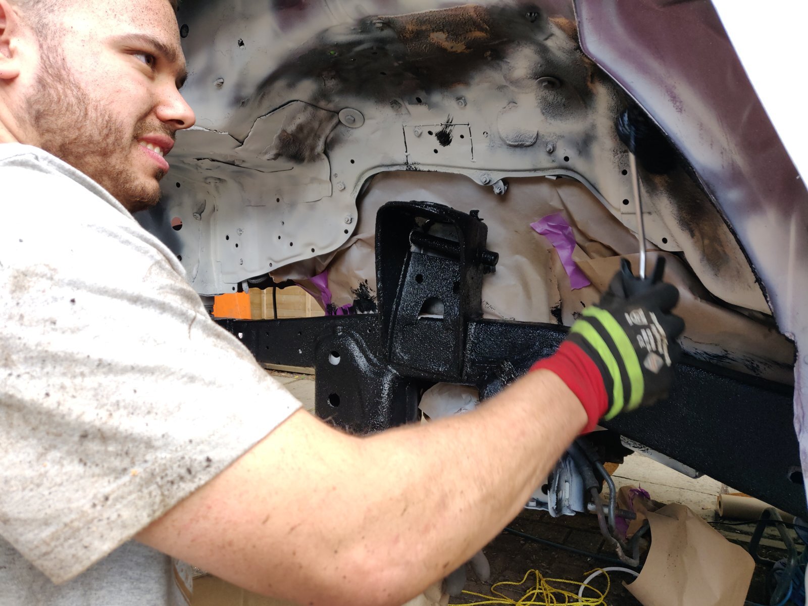

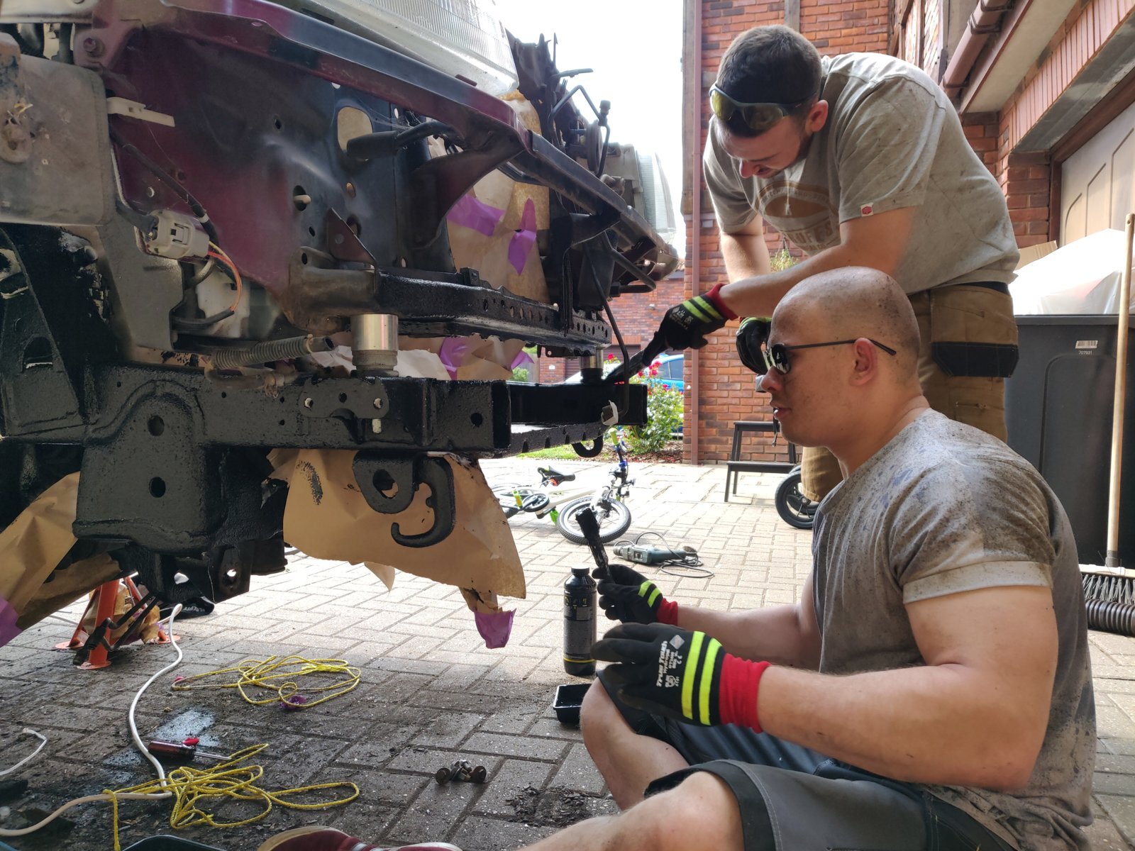

    Progress pics... Raptor on up to the mid body mounts. Front suspension and steering will be going in this week. Bbig thanks to Josh, Chris and Callum for the help!

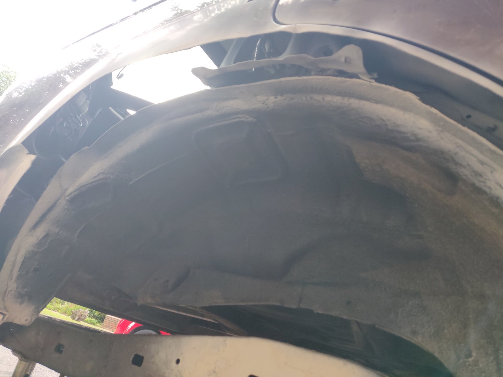

    Before cleaning up rot... And after...
    Before painting... and after....
