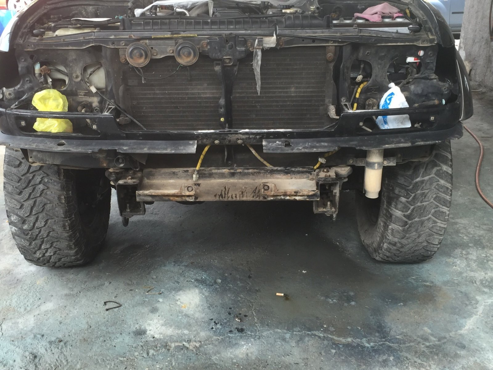

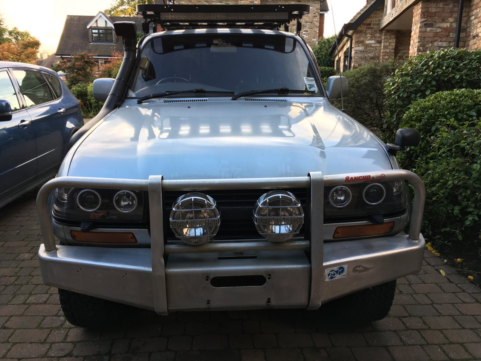

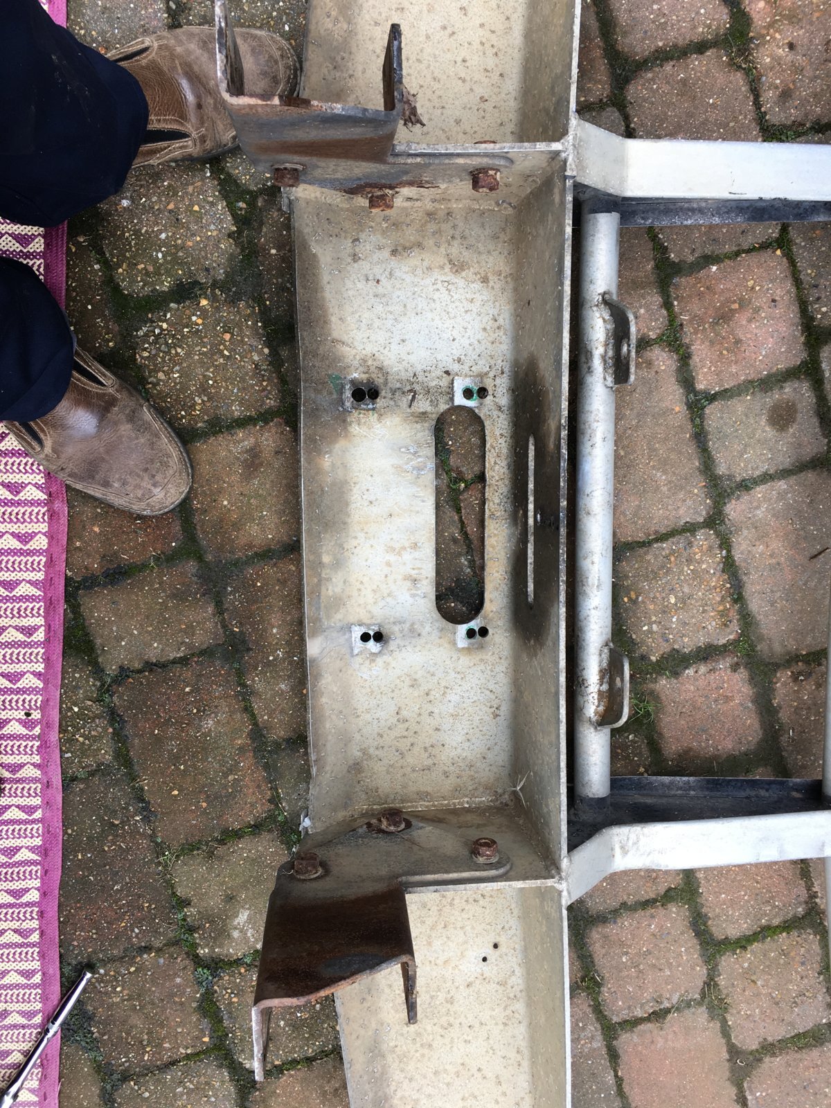

Anyway the question, it looks like the winch was attached directly to the bumper, is that ok???? Or should it go onto a Winch plate?? I have added some pictures, cheers

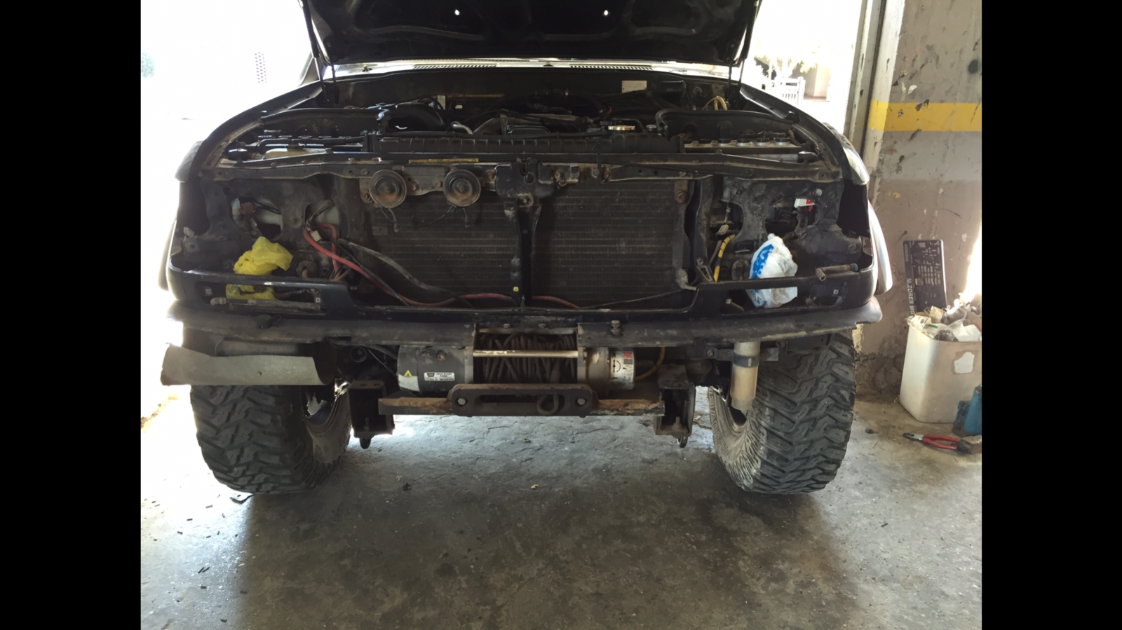

Mine was attached to a custom plate between the chassis & not the bumper. Think this would be best set up.

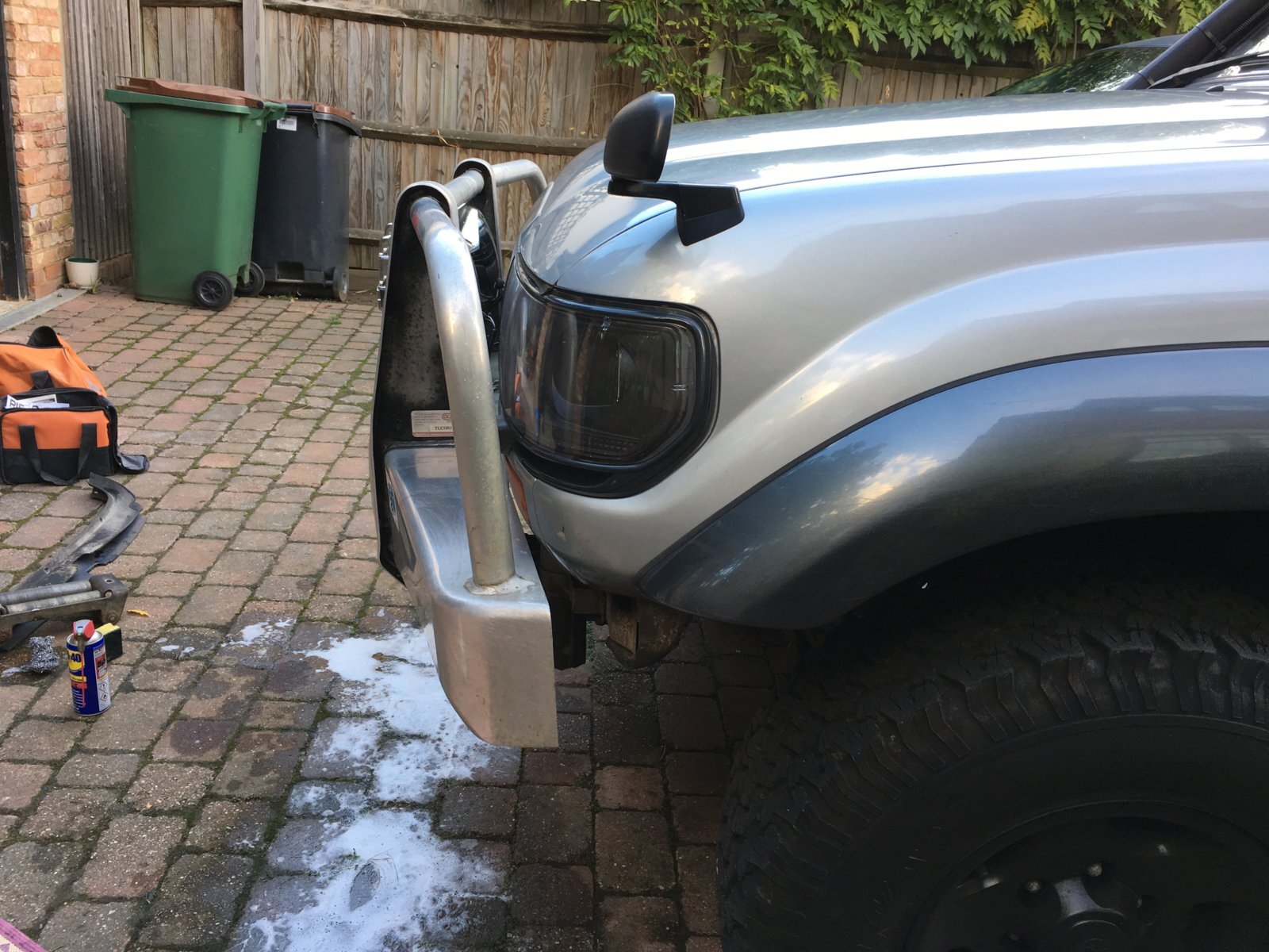

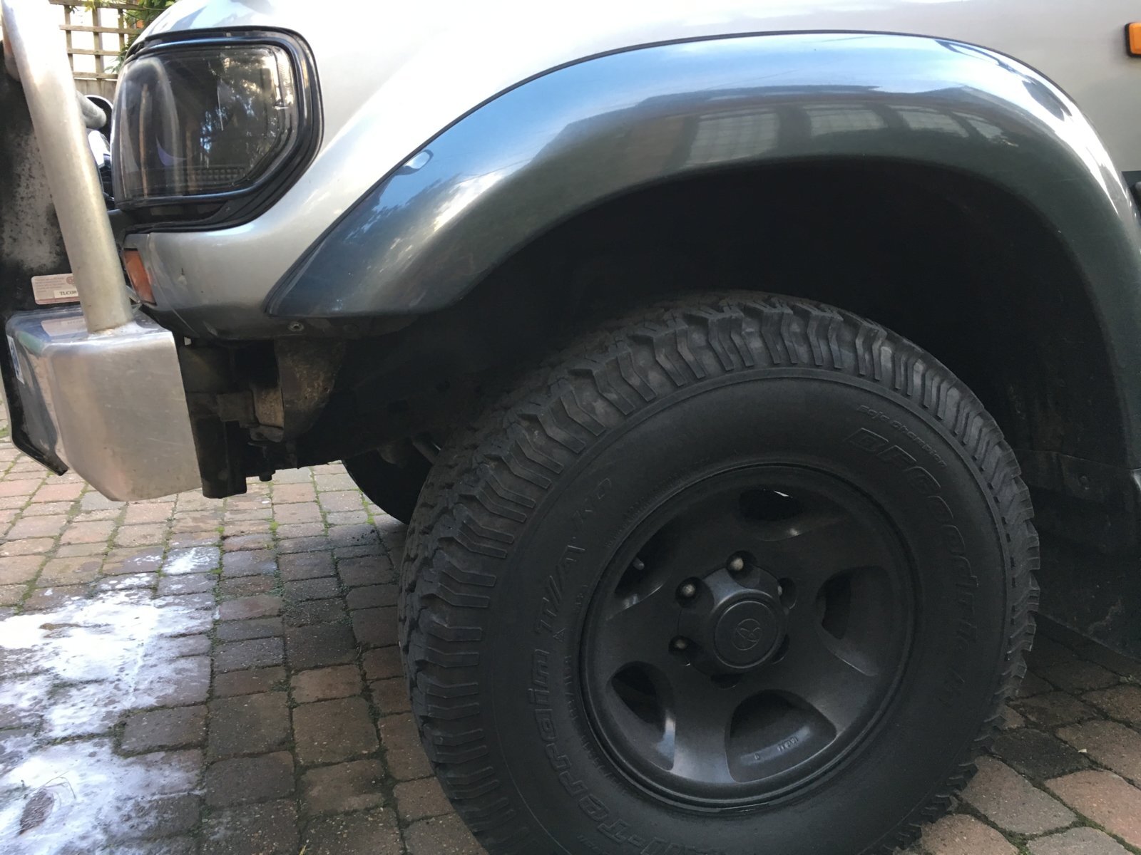

This is the bumper fitted, stuck the number plate over the hole.
Don't like the way it doesn't meet the wheel arcs, might get something made up!

Winch wants to be on a mount separate to the ally bumper. You can get universal winch mounts, that's all my winch is mounted to, might just need to drill some holes in the right place to match the chassis.
What he said - ally will not take any significant forces, it sits over the winch and mount.

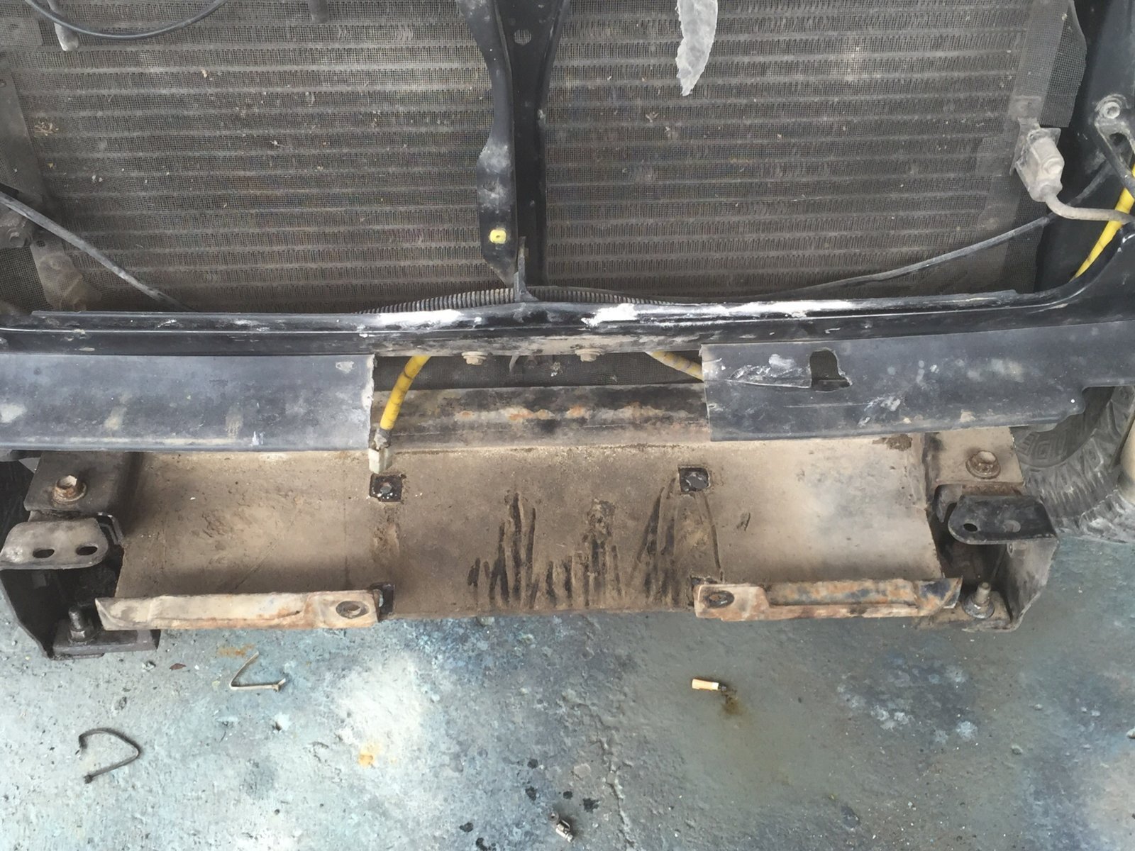

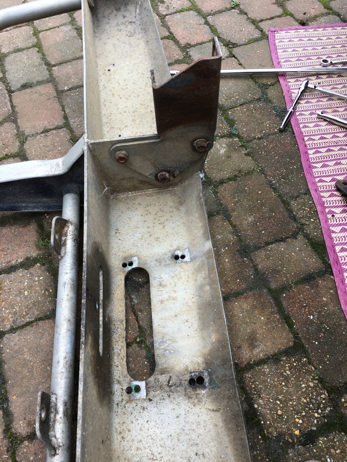

Unfortunately that's the case. Mine was made I think but can't be sure as I didn't fit it. . Pretty easy if you know hold to weld. Hope you find a easy option.

Don't winch off that bumper it will rip it's self apart.
Get a universal winch tray but just make sure you measure the chassis rails as on a 80 they are very wide and the plate could not be wide enough.
That bumper is menthe to have bolt on wings that gives back to the wheel arch.
The winch should be attached to the chassis as said above, by means of a heavy gauge steel plate.
With most steel winch bumpers, this connection is already made, but with an alloy bumper, you will need a steel winch mount plate to attach the winch to the chassis.
Cheers for the info, will look for a winch plate, have asked on the 80 series FB page to see if anybody has got the side pieces because it looks like it may have been OEM in Asia. It's a Rallyspeed/Assie bullbar if anybody is interested!!

While looking for a 90 series tray i found the off the shelf prices ludicrous considering its about 30 quids worth of metal . When i asked my local metal fab place to make me one they looked at me like i had two heads so i ended up doing it all myself but i realized during the process i could have just asked them for a couple of brackets of such and such measurements which would give me something to bolt to the chassis , then measured the gap between them and took the brackets back to the shop and ask them to weld a suitable sized plate of 6mm thick steel between them . Depends on the shop i suppose but i doubt the full cost will reach a hundred quid .

Don't waste your time with the Bolt on wings for the end of the bumper.
They are extremely effective at removing the flair from the guard if you even slightly bend the bar by nudging something. I threw mine away.
And then I threw the whole bar away and fitted an ARB bar.
