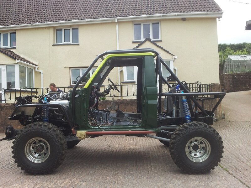

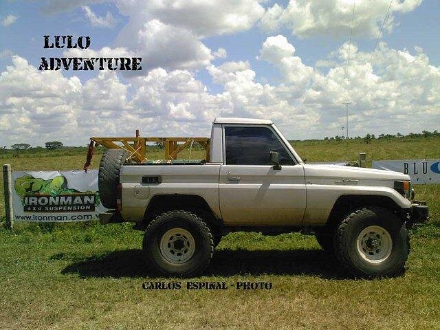

I am somewhat undecided on how much of the cab i should remove from the truck. Should I go for a pick up sort of look or just do a tube frame like one of these:
I'm leaning towards the tube frame...
That bottom one looks like Nick Bolts from Devon4x4 think its got a 5.3 Chevy engine
It is his and he is running a 5.3 LS motor I think. I'll be borrowing a few ideas from his build no doubt. I am also somewhat undecided on whether to run and exo cage or internal roll cage...
If you don't remove alot of the body work the cruiser will end up to heavy and you will be uncompetitive and on your roof alot. If it was me I would tray back as a minimum.
Space frame is the way forward really
external cage seems like it would be more useful if you keep it tight to or remove panels. Internal cages get in the way a lot and you'd end up with more weight in the external armour you'll end up adding anyway?
Nice tube bender, you'll have fun with that :thumbup:
If I were in your shoes.. I would aim to go for an external frame. Make the bonnet joined to the top of the wings and loose the lower parts of the wings under the profile line of the "landcruiser " badge and also loose the inner wings.
Square off the back of the body behind the front seats. With a tray back. . Do you intend on carrying anything with you? If not leave it open..
Great project man! :thumbup:
For a challenge truck/ultra4 it has to be external. Lets face it it will be getting rolled
